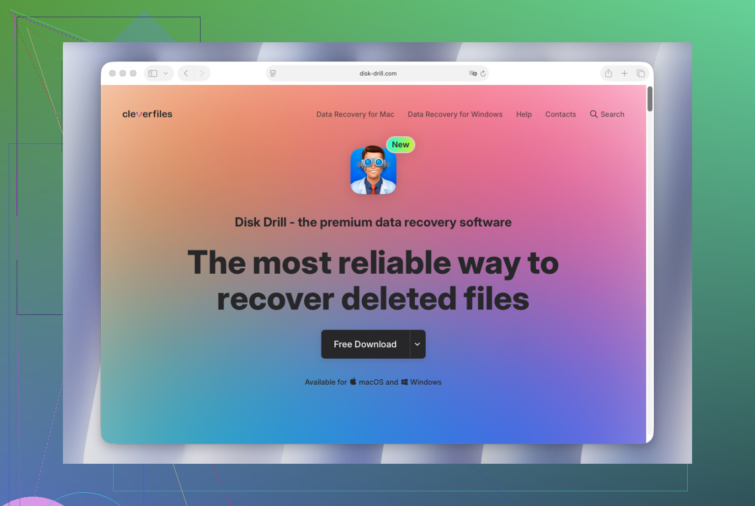

4. Recover the video with Disk Drill
Photos are usually easier. Video is messier.
A lot of cameras, drones, dashcams, and action cams save footage in pieces across the card. Basic recovery tools might find chunks but fail to put them back together in a clean, playable file. I ran into this with action cam footage a while back. The scan found the name, the size looked right, and the file played for six seconds then froze. Super anoying.
One reason Disk Drill gets mentioned for video jobs is its Advanced Camera Recovery mode. It was built for fragmented footage from supported cameras and memory cards. Instead of treating the video like one neat block, it looks through fragments and tries to rebuild the original structure. This tends to matter with files from GoPro, DJI, Sony, Canon, Nikon, Fujifilm, Insta360, and similar devices.
The process is pretty direct:
  1. Insert the original memory card using a card reader.
  2. Open Disk Drill.
  3. Select the memory card.
  4. Pick Advanced Camera Recovery.
  5. Run the scan.
  6. Wait for analysis to finish.
  7. Preview what it found.
  8. Save recovered videos to a different drive.
Do not restore files back to the same card. I know it sounds obvious. People still do it.
